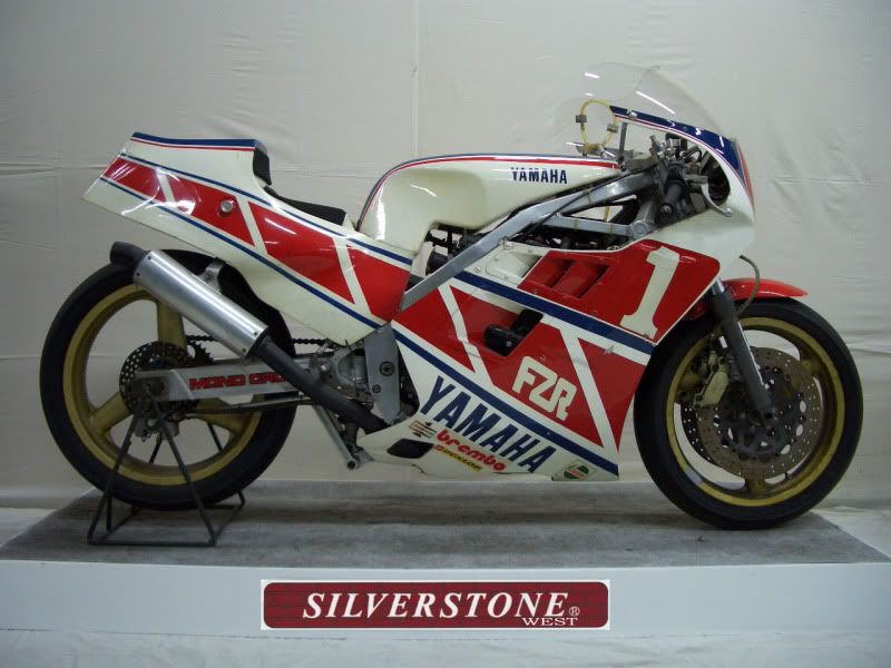

Yeah, there was an 84-85 FZR400.
But they didn't have the genisis Engines. They had they were the pre-fz engines. With an 27 degree angel cilinders (instead of the 41 degree FZR Genisis Engine)
So i doubt that the TS has one of these they are very different to the FZR engines.
Re: spare engine
I think that's the race bike - the steel framed streetbike shared the bodywork of the FZ600 but it was watercooled and as I say had a square section steel frame
