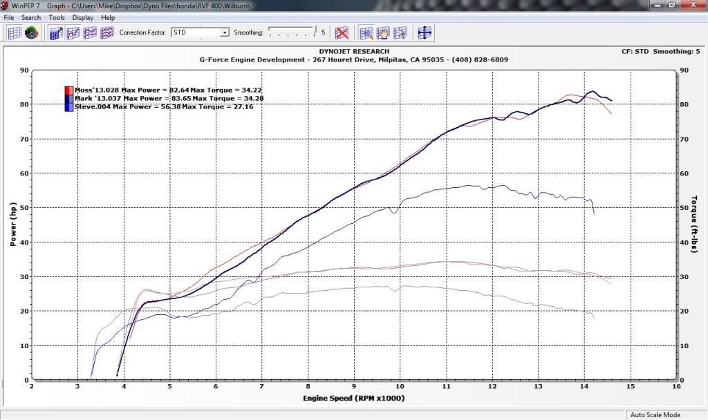

magg wrote:55mm +1 and 80+ hp race engines do not usually make good road engines. Available big bore kits are still quite expensive for just 4 piston and ring sets and the increase in capacity hardly seams worth the effort.
After a lot of research I have decided to save the money and spend it on fuel to ride as often as possible on reliable as designed by Honda NC30.
In general, I might agree with you. But, our 428cc race engines use ALL STOCK Valve Train. The heads are ported, milled and have performance full-radius valve jobs. The cams are also degreed. Some of that might decrease the low-end performance a slight amount, but we have such a gain over a stock engine that it just reduces the gains (but are still gains) at the lower end of the revs.
The image below shows two different 428 engines over a completely stock RVF400R. You can see that the power is increased everywhere. I don't know about you, but I would take the 428, 432, 440 or especially a 490 as a street bike any day. :grin: Although, our bikes do have the HRC NC-30 carbs with no airbox. So, you'd lose a bit on top, bet get even better low-end power and tractability with NC-35 carbs and an airbox.
