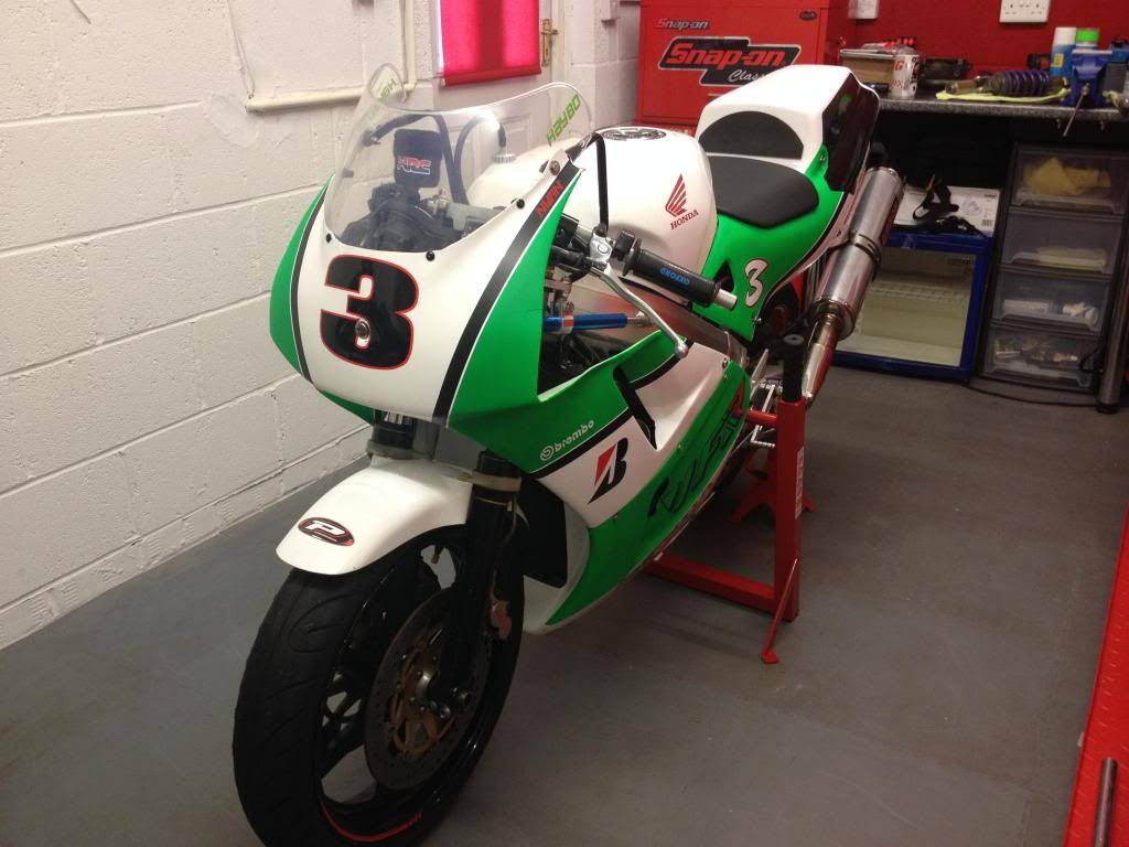

Thanks for the replies. I've fitted a Nitron Sport rear shock +15mm length and the RO fork upgrade kit to 0.9kg/mm. All set for Donington on the 26th.

bike looks great - good luck at Donnimgton
I'm sure the new suspension will be a big improvement

I've not ridden it at all yet, I will take it up the street before the 26th but its not road legal so I cant go much further. Initial impressions are really good tbh, I'm very impressed with the change. Taking into account I previously had the later standard shock but it was old and had no gas in it whatsoever. The rear is now around 40mm higher and is the best shock I've felt. Very plush. The front now has the 0.9kg/mm springs and race fluid. Its a lot stiffer up front and feels very reactive but the damping feels great too even in the garage. The bike was bad before but now it feels like its on its toes, really has transformed a tired feeling bike into a sharp fresh bike. Cant wait to give it some beans on track. I will definitely give more feedback after 26th.
