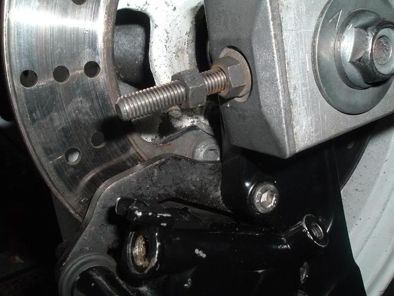

Think I've almost sorted it ;)
Been given a Kwaka KR1 rear hanger and calliper :roll:
17mm spindle and 210 rear disc same as 3EN1 :D
Spent a few hours on the lathe turning the hanger down a little in thickness and :D
Just got to have a bit of aluminium welded under the swinger to hold the tourqe arm and I'm onto the next bit .
Fred.
