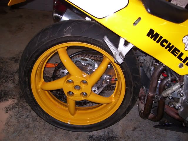

Re: NC30 17 inch rear wheel
Heres a pic of my 750 rear wheel on my nc30, if that helps you any
