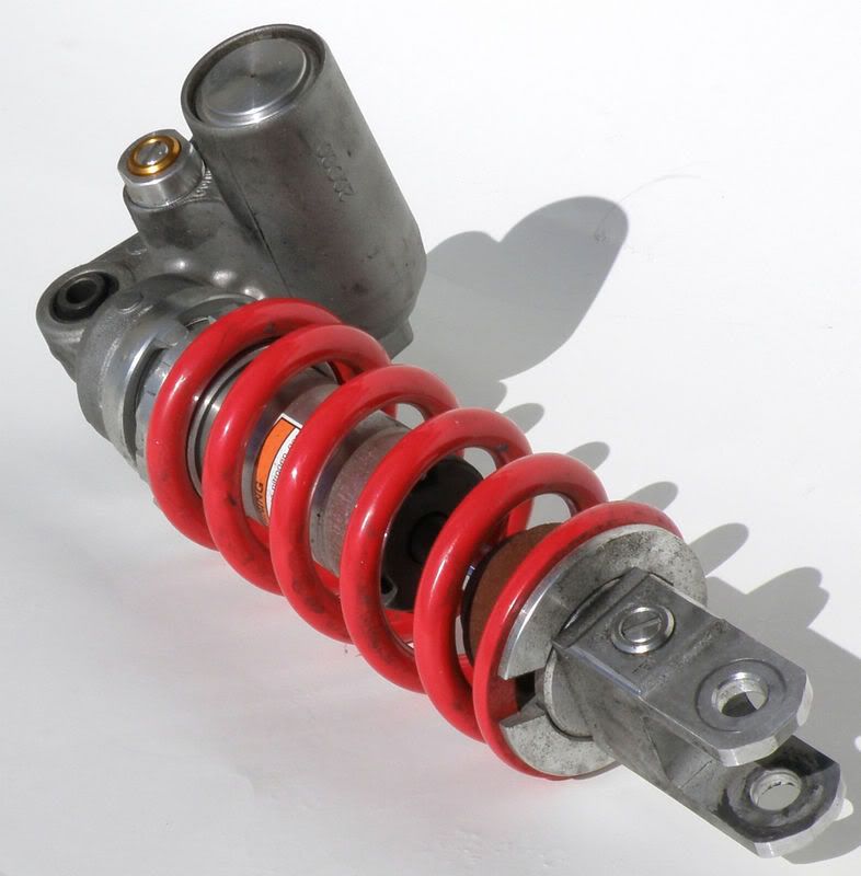

Can someone tell me is this the right shock for the 3TJ -R6 shock conversion.
Also Is it the R6 shock top bolt that is used or is it the 400 one.
Thanks

Yup thats the right shock - not sure about the top bolt

I would emagine its the 3JT bolt,as it's a 3TJ Frame,You will also need an extention addapter for the bottom mount.

I think I heard the 750 shock is close to the 3TJ's but I couldn't say for certain. They'd probably need a rebuild though so if you factor that in they're going to cost roughly the same as the R6 and shock extension.
The R6 shock is pretty good standard unit and it's a known conversion

The R6 shock top mount bolt is 10mm, but the 3TJ bolt 12mm, so you need top-hat washers or mod the 3TJ top mount locating bracket.
