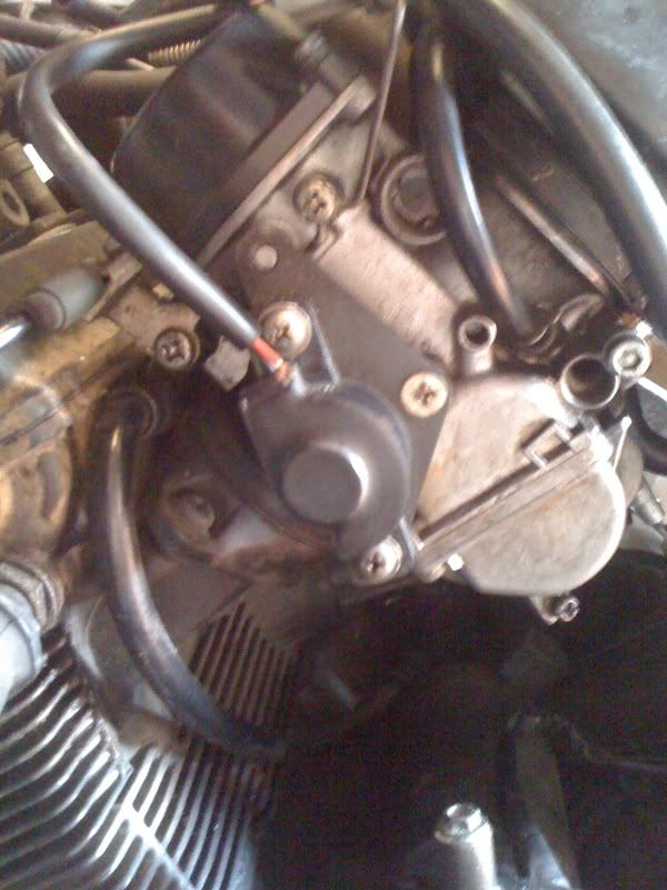

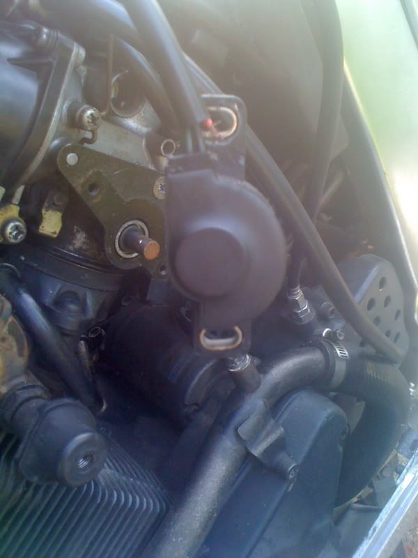

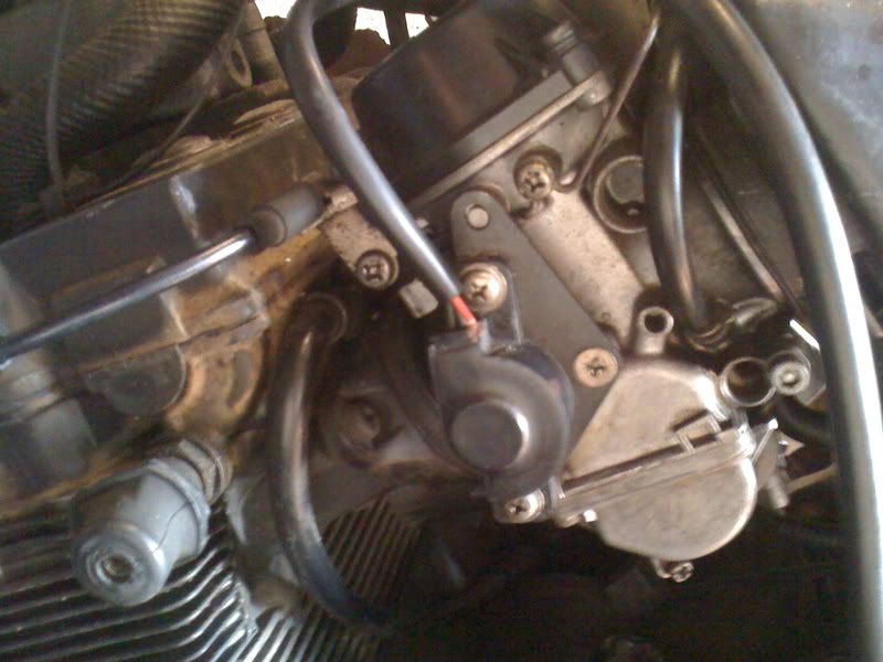

Here are some pictures of the tps

Had a look at my bike today and checked over the bike for air leaks and thankfully there wasnt any. Managed to break away some plastic on the tps to get the wire bare and im just about to solder it up. The bike started up when I connected the wire together with a little bit of choke and petrol started leaking from the overflow in the carbs which means I have a bad case of over fuelling. Going to take it to my friends house who is an mechanic and have a look at them and sort them out properly and hopefully it will work this time.
I will get a closer picture of the tps and where it has broke before I solder it.

@ Ray- you cannot simply boplt the tps sensor back on and expect the bike to run spot on. They have to be set up using the two different ohm reads for open and closed throttle. Ther is a percentage used between the two readings and i do not have the readings used for the gsxr4. There is a big write up about tps on the banditalley site for the 1200 bandit, this may give you a percentage to try.
