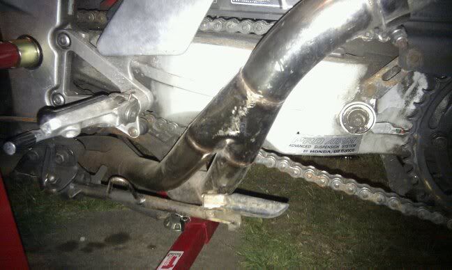

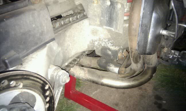

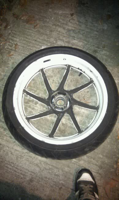

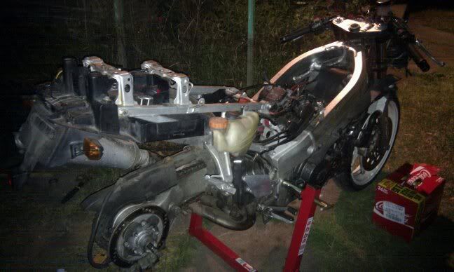

I've made a little progress, got to work on it 8-10 after work today, not much, but I got some stuff done,
this is what it looks like, I've chenged the lockset and top yoke (this was stolen recovered, they trashed the yoke trying to break the barrel out)
couple of the exhaust and inside the swing arm (cleaning work will begine properly on sunday)
and this wheel should be white, the rear is just covered in brake dust and road grime :sick:
anyone got any idea what that system is? I'm sure it's a Sansei (not just because of the can, the rear pipes are twisted)
