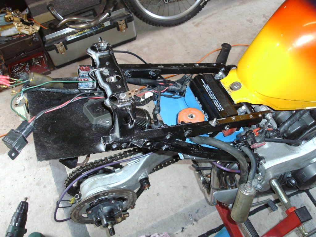

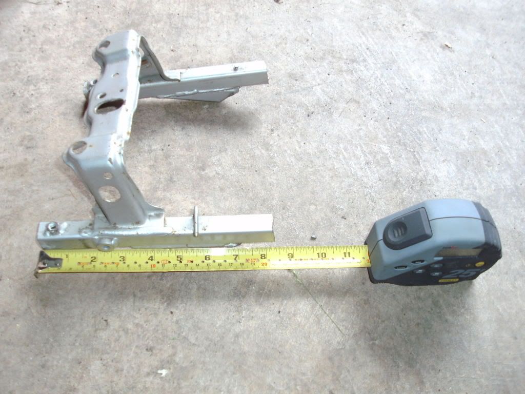

with regards to the body, i used the original vfr subframe and cut it accordingly. the mounting holes on the 600rr subframe would never fit the vfr. The other option is to make a custom alloy one, but for the cost i decided modifing the original would be just as simple and more cost effective.
i lost this much in modifying the sub frame

the vfr has a remote res with the shock, as do some after market ones ( dont think the rvf does thought ) but with my subframe & undertray this was not going to be any good so i then changed to a sv 650 shock. not the best shock in the worls but its not like the wife will really tell any difference and its an improvement of the 20 year old original anyway.
if you modify the subframe, and use the standard exhaust or a aftermarket system / can you will need to make a new hanger to cover the extra distance & I think that is about it, some wiring in places will need extending, some relays adding to the headlights as the 600rr runs the one high- one low system.

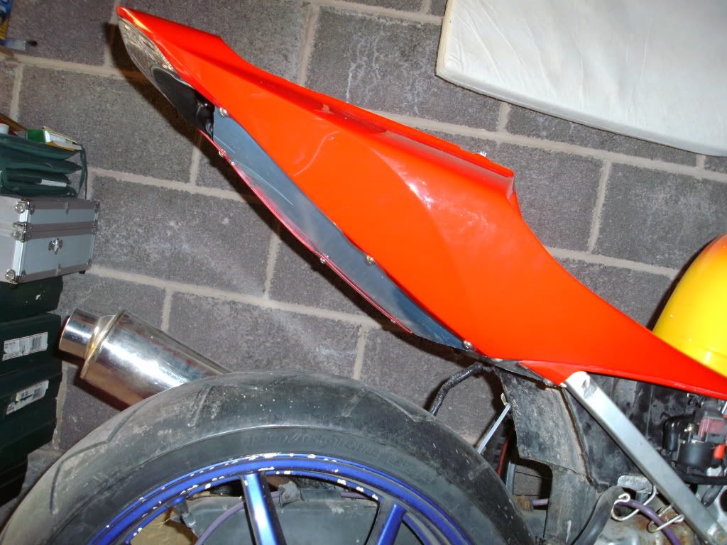

A tyga system is far easier to fit as it has been 'mass produced' and has been designed to fit these bikes. To be honest, your on a restricted licence its only for a couple of years, i would go with standard fairings or even a chinese set. My guess would be as soon as your licence allows you will move to a bigger bike - is all of the work the time / effort & money?
The nc30 we have is for my wife, she is only small so the size of the vfr is great for her. However she likes the modern look of the cbr so i started to build the above. I have my blade for daily use and she has the car for the kids, it is two years on 10th jan since i started the above. Doing bits after work, days off etc - so if your want to go this route have you another vehicle to get about on?

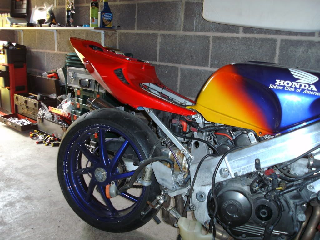

so im now at this point.
just got a couple more jobs to do. The tank is going back for another re-spray as the colour is not the same as the panels. then time for the mot, do i like how she has come out...yes, do i like the fact shes different....yes, would i have started this if i had known it would take over two years.....erm, ask me when im finished!
