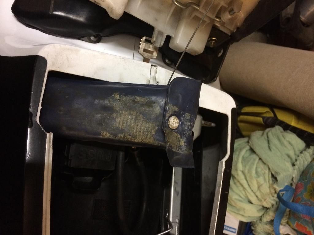

Forgot to mention I opened the rear set unit and found this inside. Need to give the case a good clean though.
Overall it's a cracking looking bike but I'm still not sure wether to put on the new RR bodywork or not, never been a fan of the RT colour scheme.
