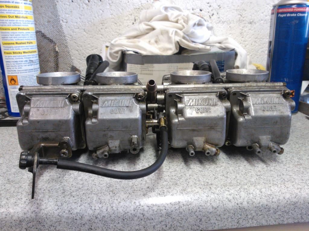

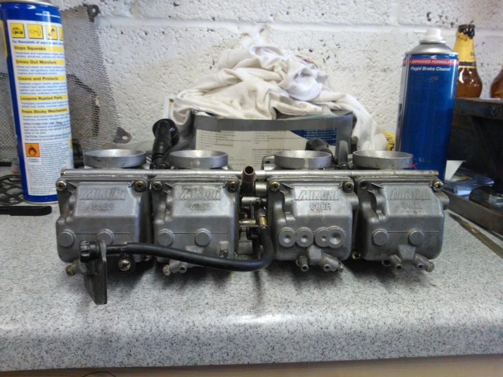

This was taken in the garage after warming it up but its worse when out riding, logic says its an air leak but i cant find one. Ive removed the carbs for a clean up anyway and upon doing so noticed there different than the carbs i originally tried and failed to get the bike started with, this is the running set ive just removed
And this is the original set i had no luck with,
If you look closely your notice the original set has 4 float bowl screws and the running set only has 2, are they both 3TJ or do i have something else here?

The top set look the same as my 3TJ1 carbs.
cheers

I guess that explains why i could never get it running with the other set then.LiteTekBlair wrote:The top set look the same as my 3TJ1 carbs.
cheers
Stripped, cleaned and checked the running set and jets and settings are all stock as per the manual although upon checking the plugs which were white so that suggests im running lean, float bowl seals are also manky so ive just ordered a full set of viton seals off your site. Once thats done i'll get it on the dyno to check the fueling and see what it makes before fitting the FCR's to compare.
Once back together the revs still hanged as before but if i dropped the idle speed to 1100-1200 rpm it solved the problem, not sure if this suggest ive a problem elsewhere as the idle speed was barely 1400 rpm to start with, still cant find any air leaks.
