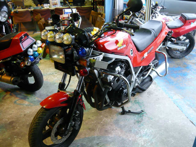

I believe the differences between the Z and the R are purely cosmetic; the Z just has no fairing but a bellypan and twin headlights. The K model was also available (for a few years after the other two bikes in Japan) and was designed as a training school bike. I'm not too certain of the differences between it and the Z apart from the crazy 'Christmas tree' lights, crash bars, single headlight, more upright handlebars and a centre stand.

the K bikes were indeed the stock training school bike, if you ever coem across one it will be white or blue (blue are the later models)
in training school trim they have werid rear lights as they flash different lights when rider at training school is using brake / clutch etc.. easily converted to road trim with lights and loom.. chances are never see an ex trainign school bike still wtih training lights on it.

What's wrong with a few extra lights? Beauty!

they still use those lights on the training school bikes just not vfrs now.jim157 wrote:Crazy bikes, I really like them.
lets the instructors see what your doing on the bike so they can correct any bad things.
