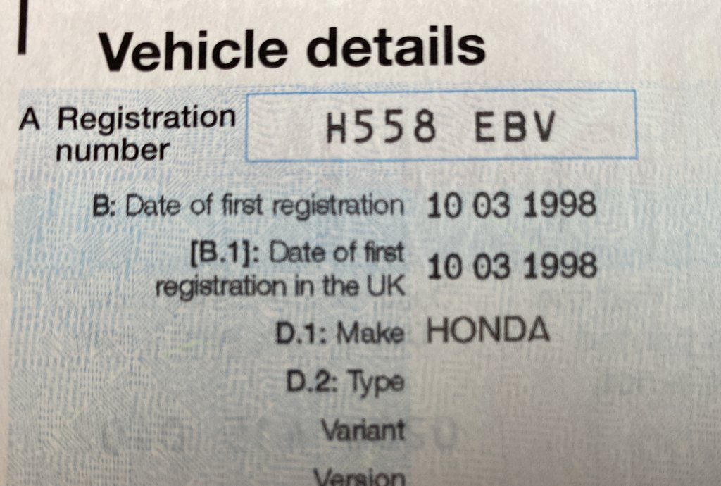

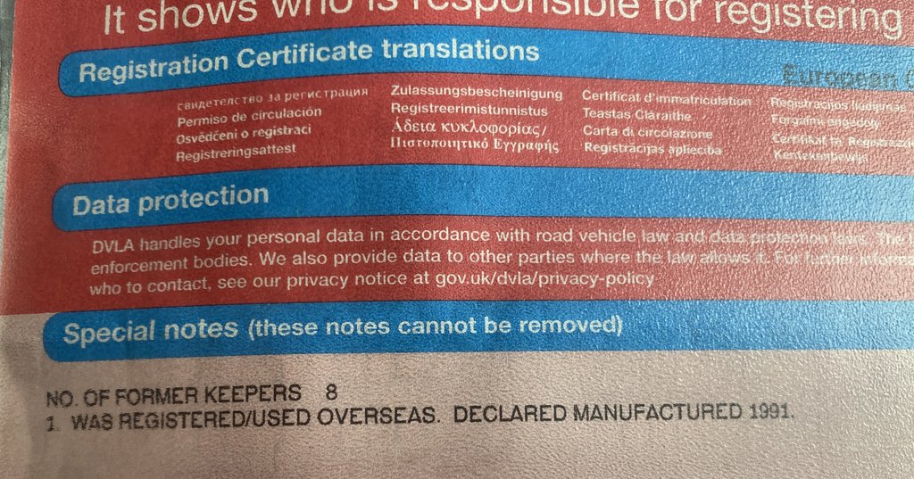

If you have a UK V5 document for the bike it will show on the front page (under Special Notes) that the bike was registered abroad and "Declared manufactured in (eg) 1991"
This is your proof of how old the bike is.
The date of first registration (on the second page) refers only to when it was first registered in the UK
